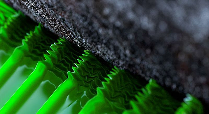

Last week Bontrager launched a new helmet material that claims to be the panacea of head protection. Dressed in the same translucent green colour Koroyd became famous for and marketed under the trademark WaveCel, this open-cell material is claimed to decrease acceleration from linear impacts and reduce the rotational forces on the brain under oblique impacts.
By merging these two approaches to head protection and by making substantial safety claims, you could be forgiven for thinking WaveCel has now closed the book on the linear and rotational discussion, which has been going on for the past 20 years. One journalist has even dubbed this new “holy-grail” technology as ‘Koroyd 2.0’ which would be a fitting title - IF you chose to believe the hype.

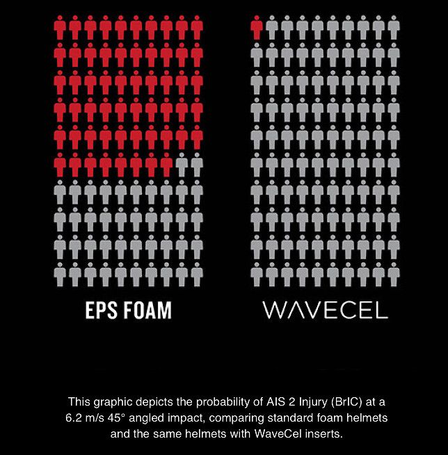

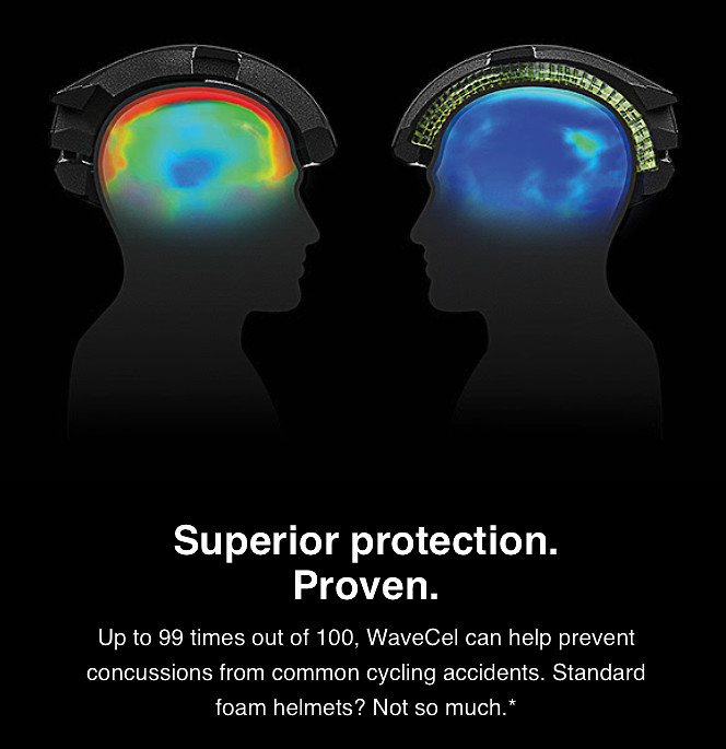

""*Results based on AIS 2 Injury (BrIC) at 6.2 m/s test at 45° comparing a standard EPS Helmet and the same helmet modified with WaveCel insert as described in detail in Comparison of Bicycle Helmet Technologies in Realistic Oblique Impacts."
Though that may constitute a concussion, all concussions do not constitute this specification.
I can't believe their legal team let them run with this one. Its insane to me. This type of test is a very specific type of hit to the head, and clearly does not encompass AIS 1 injury or a brain injury that would still constitute "concussion" but note register under such elementary quantitative testing.
End of the day, this claim is flat wrong, or at least its a (very) partial truth. This helmet is 99% better than a run of the mill foam helmet in preventing this exact type of injury, which may be one type of a concussion. It is not preventing 99% of concussions across the board.

I ask because I'm sure it's easy to say that a helmet is 48x safer today versus early 2000s. But if the standards were updated recently....
As far as standards changing you are assuming *way* too much. I mean that in the nicest, most "you have common sense but they don't" way possible.
You'd think we'd be looking at how we ride, what we know about brain injury and build helmets in a best practices kind of way based on those two factors. We don't. The testing standards aren't from the Bender days, they aren't even from the Marzocchi Super T days. When the helmet certification regs were developed Seinfeld had *just* gone off the air.
As far as 48x safer, I don't think they are comparing it to current safety standards but they rather claim its 48 times better at preventing concussions...which again, I frankly don't know how you quantify that when we know so little.

https://www.helmet.beam.vt.edu/bicycle-helmet-ratings.html
in the email under this first graphic is a link that says "explore wavecel" which goes to - https://wavecel.trekbikes.com/us/en_US/
under this 2nd graphic there's a "*read the full study" link that goes here - https://www.trekbikes.com/us/en_US/what-is-wavecel/
i don't think there's anything new here, just a different presentation?
