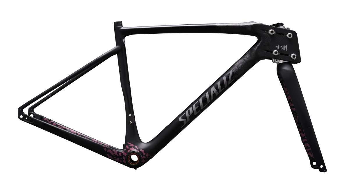

You can bet your ass companies do this, but this is what makes the knowhow their secret sauce and their products better. So you won't see it published much. Spec had a headangle/reach mule of a gravel bike, the Enduro mule looked https://ep1.pinkbike.org/p4pb17581909/p4pb17581909.jpg, etc.

That's super cool to see that Specialized was doing actual testing on reach length vs. stem length to see how they affected steering. Always cool to see real test mules to do back to back testing. So much of bicycle geometry conventional wisdom is just guesswork and accidental discoveries. Curious what they discovered. Obviously, they chose to go with longer reach lengths and shorter stems across the whole diverge lineup, but I wonder if they found a "too-short" stem length for road bikes.
