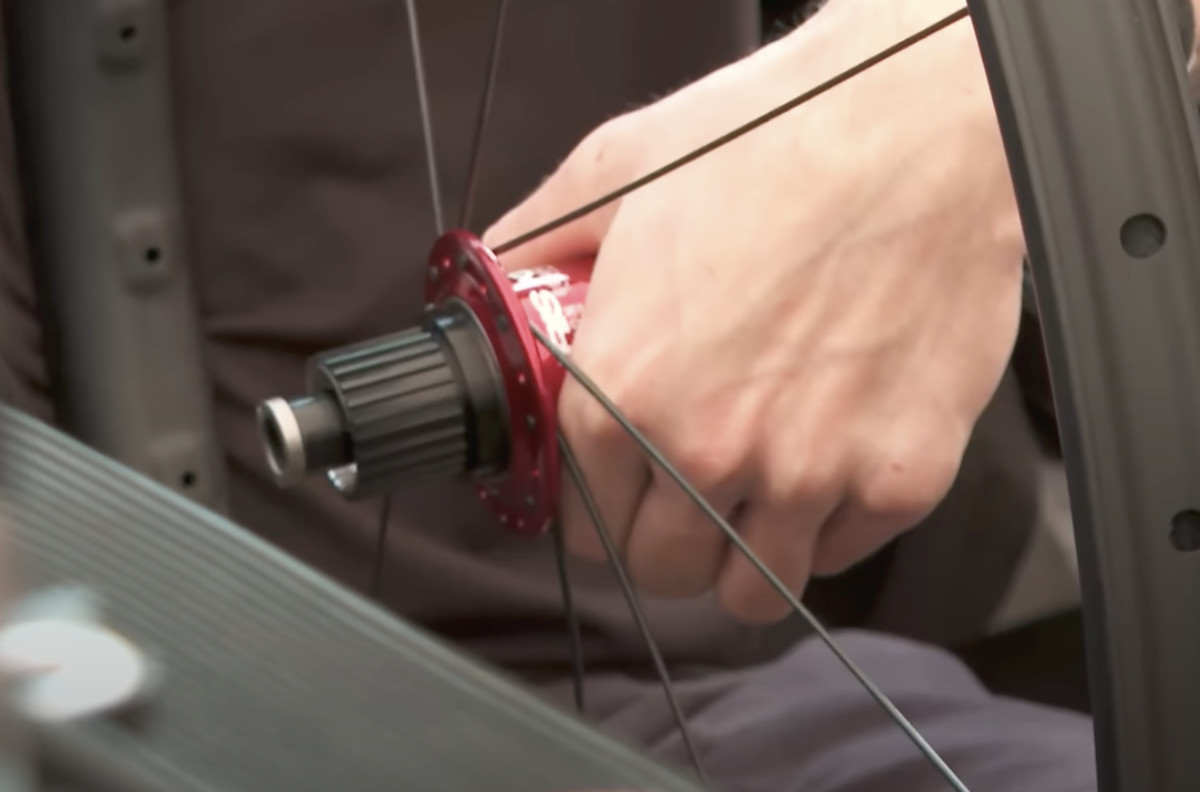

[img]https://p.vitalmtb.com/photos/forums/2022/03/25/12269/s1200_Screen_Shot_2022_03_25_at_8.42.55_AM.jpg[/img]
saw this in [url=https://www.vitalmtb.com/videos/features/Lourdes-World-Cup-Downhill-Bike-Tech,39853/sspomer,2]our pit bits video[/url] - is this for a DH/saint microspline cassette? i'm not super familiar w/ the full run of shimano...
saw this in our pit bits video - is this for a DH/saint microspline cassette? i'm not super familiar w/ the full run of shimano stuff, but syndicate rear wheel w/ microspline chris king hub. do they make compact microspline cassettes that a DHer would use?
My guess the stuff Greg is riding is microspline cassette for dh
Would seem silly to ride Shimano and not get the benefits of changing under load with the new chain and cassette. I mean they ran the new XTR brakes and stuff so it seems logical they would use parts of the new drivetrain…. Although I suspect the new Saint will include it anyways
Actually, the Shapeshifter isn't that useless. I used it a LOT on my first gen Strive. Short travel/high for climbing and flat, and long travel/low for...
Actually, the Shapeshifter isn't that useless. I used it a LOT on my first gen Strive. Short travel/high for climbing and flat, and long travel/low for plush downhill. It worked very well for me.
They are almost the same product. One eyelet of the shock is attached to a short link that changes the sag, progression, and travel of the bike. The Canyon is manually toggled, while the old Magic Link is toggled by pressure on the chainstay.
Good point on the wheel being for another bike. Only the 12spd 10-51 cassettes (Deore included) are Microspline, no other cassettes are on MS yet as far as I know. Their road stuff is still 11spd, so HG freehubs fit the bill. Roadies hate 10spd cogs, even Sram had to put out a new cassette and front chainrings with an 11spd smallest cog for the pros to make them happy.

Good point on the wheel being for another bike. Only the 12spd 10-51 cassettes (Deore included) are Microspline, no other cassettes are on MS yet as...
11T, not 11spd obvs... What a mistake.
There is a 10-45t Shimano 12-speed cassette as well that is also on Microspline (it's what I have now on my trail bike). I have the XTR but I believe there is an XT version as well.

There is a 10-45t Shimano 12-speed cassette as well that is also on Microspline (it's what I have now on my trail bike). I have the...
They do. They also started producing a medium cage xt derailleur to go with it. Don’t have to spring for xtr if you choose clearance and weight over the pie plate.
I’m really hoping the new saint/zee has a long cage/larger cassette option like the zee fr. Still rocking the zee fr personally. Such a good drivetrain for the $$$. If they release one with smoother shifting and a slightly larger range I’d be all over it.
I know there's a 10-45 (I think I mentioned it somewhere too), but 45 is still way too big for DH... Looking at Sram's 7spd cassette even the Shimano 30T road cassette is big.
